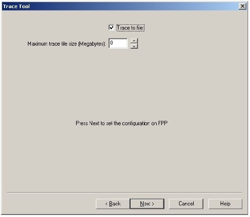

The Trace Tool is a troubleshooting tool that allows you to either enable or disable the trace file, and specify a maximum files size so the trace file does not grow too large and compromise Enterprise performance. The trace file is located in C:\Documents and Settings\User\My Document\Xerox Interface\XGTrace.txt.
In the Finish Wizard window, click Finish or use the Cancel button to exit the setup and revise the configuration settings.
