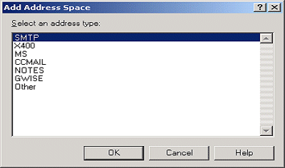

5. Select the Address Space tab. You must modify the default settings by selecting the Routing group radio button, and checking the Allow messages to be relayed to these domains option. Click Add
6. In the Add Address Space window, select the SMTP address type and click OK. Address spacing information determines the way Exchange clients will address messages to the Gateway.
