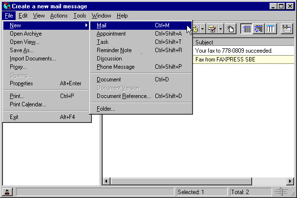

2. From your GroupWise Mailbox, bring up a new Mail To: message window. (Select File>New>Mail.)

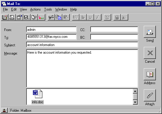

3. In the To: field, enter the recipient fax number ‘at’ your SMTP Gateway. (To include additional recipients, use semicolons as delimiters.)
4. In the Subject field, enter a brief description of your fax.

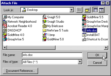

5. Click the paper clip icon to attach a file for the fax recipient to your mail message. The SMTP Gateway allows you to attach document files (specified by the Email Gateway for Generic SMTP administrator) in their native format, which the Email Gateway for Generic SMTP then converts to faxable DCX format.
6. The Insert File dialog box allows you search for the document you’d like to fax. Select the document, then click Insert.
7. Your fax is now ready to send. Use key codes and characters to include information in addition to the recipient’s fax number (i.e., the recipient’s name, voice number, company, your voice number, etc.) on your fax’s cover page.

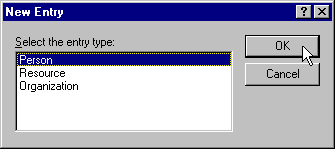

3. In the New Entry window, select Person, then OK.

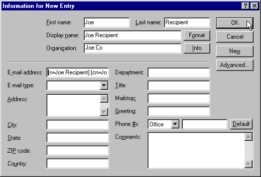

4. Enter the recipient’s name and email address information, then click OK. This recipient will now appear in your contacts list.
