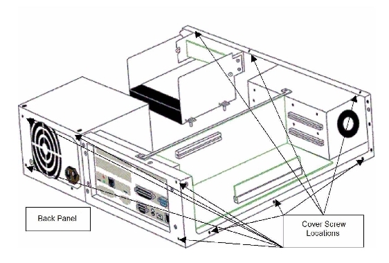

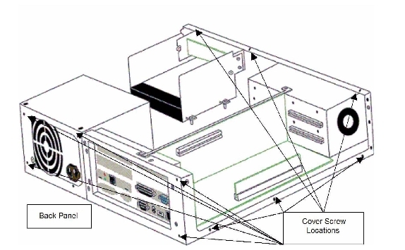

3. Remove the 5 cover screws holding the cover of the FaxPress Premier to the back panel, the 3 screws holding the bottom of the cover to each side of the chassis, and the 2 screws holding the front edge of the cover under the lip at the top of the front panel. The screw directly above the thumbscrew for the fan unit cover does not need to be removed, but may need to be loosened.
Remove only the FaxPress Premier cover screws - do not remove any other chassis screws.
4. Remove the cover by sliding it toward the rear of the FaxPress Premier, then lifting it upwards when it is free of the front panel lip.

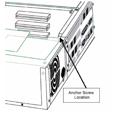

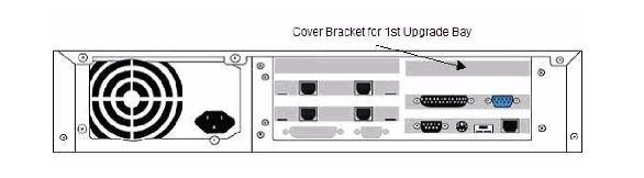

5. Locate the cover bracket that is covering the bay directly above the parallel port (RS-232) and serial port (DB-15) connectors on the rear panel of the FaxPress Premier, as shown below.
6. Remove the Phillips screw that is anchoring the cover bracket and remove the cover bracket from the bay. You can get access to the anchor screw from the side of the FaxPress Premier chassis, as shown below.

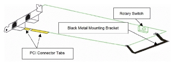

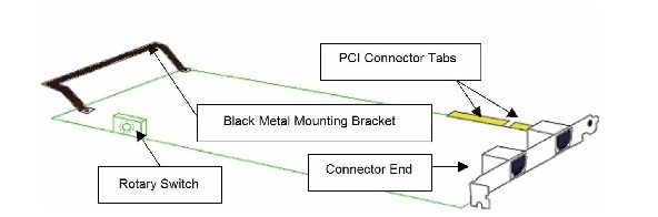

8. Set the rotary switch, found near the metal bracket end of the board, to a unique number (see the figure after Step 9 for location of the rotary switch). Typically, two analog boards were installed at the factory, with the numbers set to 0 and 1, and you can set the number of the upgrade board to 2. In short, you can set the upgrade board’s rotary switch to any number other than those used for the previously installed analog boards.
9. Align the board so the black metal end-bracket angles DOWN from the board, as shown below.

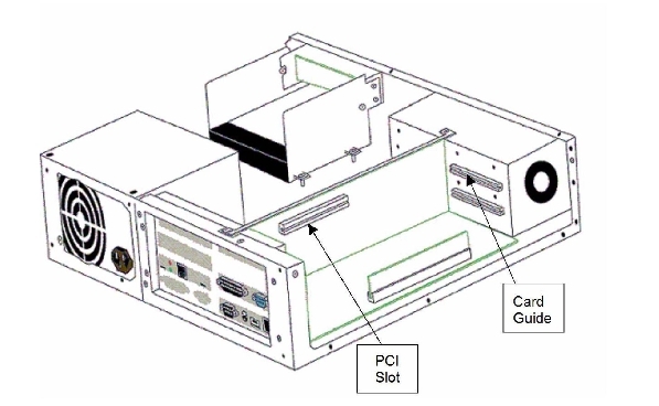

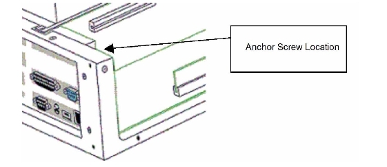

10. Slide the board into the FaxPress Premier Chassis, with the black metal mounting bracket sliding into the card guide, and the PCI connector tabs aligned so they plug into the PCI slot on the chassis smoothly and firmly, as shown below.
11. Replace the anchor screw to hold the upgrade board firmly in place.

3. Remove the 5 cover screws holding the cover of the FaxPress Premier to the back panel, the 3 screws holding the bottom of the cover to each side of the chassis, and the 2 screws holding the front edge of the cover under the lip at the top of the front panel (the screw directly above the thumbscrew for the fan unit cover does not need to be removed, but may need to be loosened slightly, as shown below.
Remove only the FaxPress Premier cover screws. Do not remove any other chassis screws.

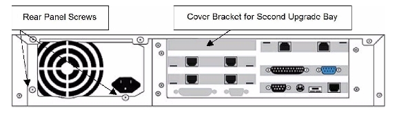

5. Locate the power supply module in the FaxPress Premier chassis, as shown below.
6. Remove the 2 nuts with lock washers that hold the power supply to the base of the FaxPress Premier chassis. You may need to use needlenose pliers for this task.
7. Remove the 2 rear panel screws that hold the bottom portion of the power supply to the rear panel of the FaxPress Premier. (See the figure following step 10.)
8. Move the power supply to the side of the chassis, as far as the lines will allow.
9. Locate the cover bracket on the top bay above the factory-installed analog boards, as shown.
10. Remove the Phillips screw that is anchoring the cover bracket and remove the cover bracket from the top bay.

12. Set the rotary switch, found near the metal bracket end of the board, to a unique number (see the figure following Step 13 for location of switch). Typically, the two factory-installed analog boards will be set to 0 (zero) and 1, and the first upgrade board will be set to 2. If this is the case, you can set the number on your second upgrade board to 3. In short, you can set the upgrade board’s rotary switch to any number other than those used for the previously installed analog boards.
13. Align the board so the black metal end-bracket angles UP from the board, as shown below.
14. Engage one end of the black metal mounting bracket (the end that the arrow is pointing to above) in the card guide, then lower the connector end of the board and slide the board into place, aligning the PCI connector tabs so they plug into the PCI slot on the chassis smoothly and firmly, as shown below.

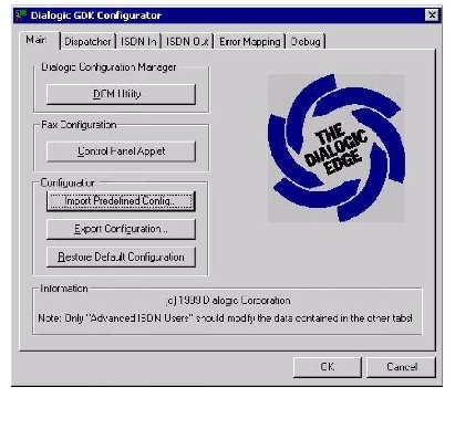

13. When all Castelle FaxPress Premier services are stopped, open the Dialogic GDK Configurator by selecting:
Start>Programs>Intel Dialogic System Software>Configure GDK

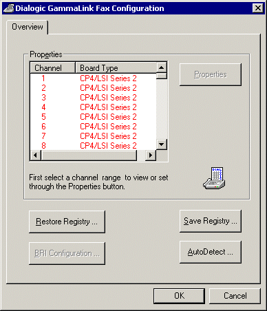

14. In the Dialogic GDK Configurator’s Fax Configuration section, click the Control Panel Applet button to open the Dialogic GammaLink Fax Configuration interface.
15. Click the AutoDetect button. A warning message appears.
16. Click OK. When the auto-detection process is complete, a message box appears, indicating that all boards have been detected.
17. Click OK in the message box. The Dialogic GammaLink Fax Configuration window now displays the new number of supported fax lines, as shown above.
18. Verify that this number is correct, and then click OK to exit the Dialogic GammaLink Fax Configuration window. Click OK to exit. This completes the configuration for your analog board. Next, configure the FaxPress Premier server software according to Running the FaxPress Premier Upgrade Software .
