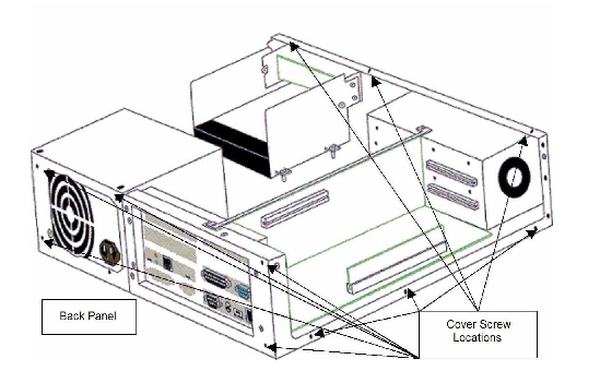

3. Remove the 5 cover screws holding the cover of the FaxPress Premier to the back panel, the 3 screws holding the bottom of the cover to each side of the chassis, and the 2 screws holding the front edge of the cover under the lip at the top of the front panel. The screw directly above the thumbscrew for the fan unit cover does not need to be removed, but you may need to loosen it slightly.
Remove only the FaxPress Premier cover screws. Do not remove any other chassis screws.
4. Remove the cover by sliding it toward the rear of the FaxPress Premier, then lifting it up when it is free of the front panel lip.

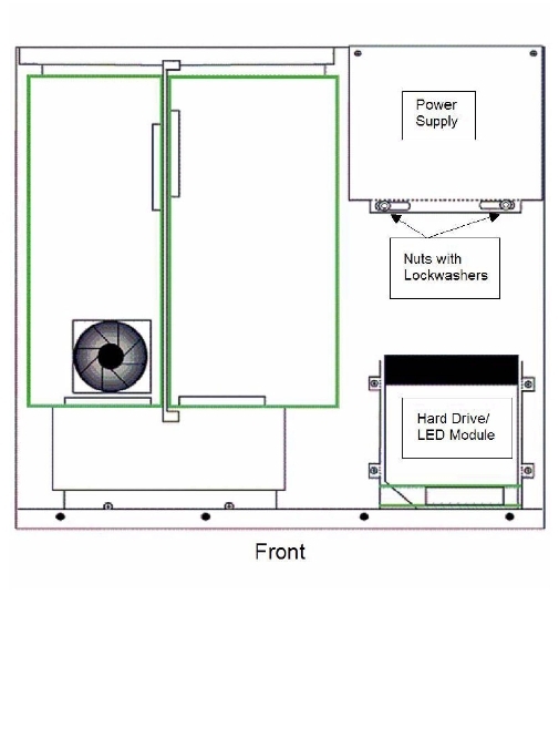

5. Locate the power supply module in the FaxPress Premier chassis.
6. Remove the 2 nuts with lock washers that hold the power supply to the base of the FaxPress Premier chassis. You may need to use needlenose pliers for this task.

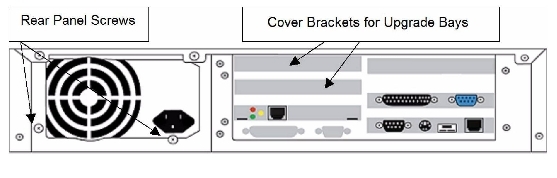

7. Remove the 2 rear panel screws holding the bottom portion of the power supply to the rear panel and move the power supply to the side of the chassis, as far as the cables will allow.
8. Locate the cover brackets covering the bays above the factory-installed ISDN BRI board(s).
9. Remove the Phillips screw that is anchoring the cover bracket and remove the cover bracket from the lower bay, if this bay is not occupied by a board. If the lower bay is occupied by a board, remove the Phillips screw that is anchoring the cover bracket for the upper bay, and remove that cover bracket.

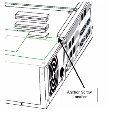

12. Engage one end of the black metal mounting bracket (the end the arrow is pointing to above) in the card guide, then lower the connector end of the board and slide the board into place, aligning the PCI connector tabs so they plug into the PCI slot on the chassis smoothly and firmly.
13. Replace the anchor screw, to hold the upgrade board firmly in place. If only one ISDN BRI board was factory-installed in the chassis, install the ribbon bus cable supplied with your upgrade kit on that existing ISDN BRI board, and then connect it to the upgrade board you have added, attaching it to the connectors shown below.

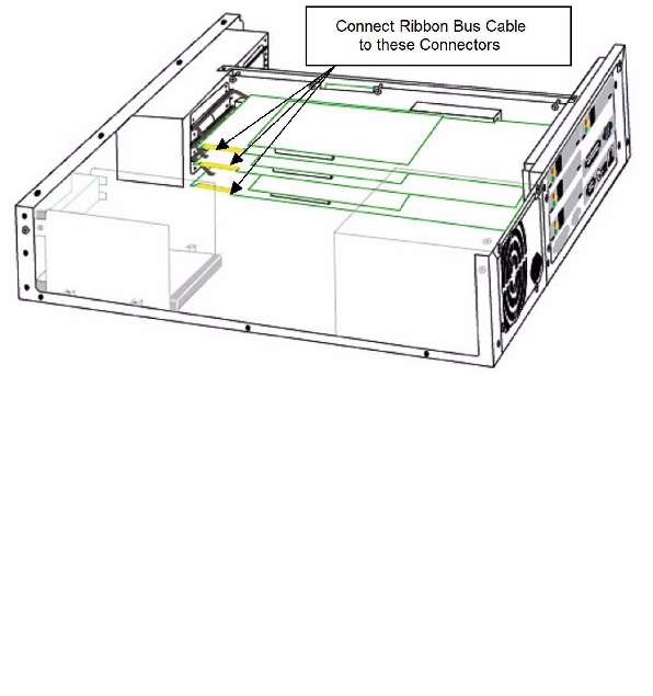

14. Make sure you install the ribbon bus cable with the lock (hook) ends of the connectors toward the BACK PANEL of the FaxPress Premier chassis, as shown below. This orientation will mean that the hooks are on the ends of the connectors that are AWAY from the Black Metal Mounting bracket, as shown. To add 2 upgrade boards, connect the ribbon bus cable to both of the new boards.
15. If two boards were factory-installed prior to this upgrade, the ribbon bus cable will be in place; simply push the appropriate cable connector onto the board connector of the new board. Press the connectors firmly into place, to make sure there is a solid connection.

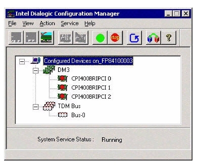

8. When all Castelle FaxPress Premier services are stopped, open the Start menu and select Programs>Intel Dialogic System Software>Configuration Manager-DCM
9. In the Intel Dialogic Configuration Manager window, right-click on Configured Devices on_FPxxxxxx and select Restore Device Defaults tomake the system rescan the boards.
10. During the detection process, the Assign Firmware File window opens, and displays a choice of two .pcd files, cpi400bripcipmp.pcd and cpi400bripcipp.pcd.
11. Select the cpi400bripcipp.pcd file and click OK. The software scan of the boards continues until complete. Then the Intel DCM window reappears, with all of the boards listed, and a red light displayed in each device icon.
All boards should use the same .pcd file.
12. Select the first board (for example, CPI400BRIPCI 0 in the above example), and then click the green Start Service button in the menu bar. A progress bar appears on top of the background screen, indicating the progress of the service startup. When all boards are started (all of the lights in the device icons are green), select the File>Exit command.

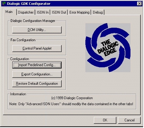

13. Click the Start Menu and select:
Programs>Intel Dialogic System Software>Configure GDK
to open the Dialogic GDK Configurator window.

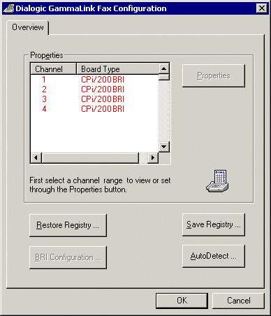

14. In the Fax Configuration section, click the Control Panel Applet button. The Dialogic GammaLink Fax Configuration window appears, as shown below.
15. Click the Auto Detect button. A warning message appears.
16. Click OK. When the auto-detection process is complete, a message box appears, indicating that all boards have been detected.
17. Click OK in the message box. The Dialogic GammaLink Fax Configuration window now displays the new number of supported fax channels, as shown below.
18. Verify that this number is correct. Then click OK to exit the Dialogic GammaLink Fax Configuration box.

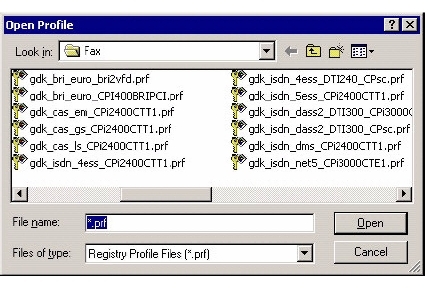

19. Click the Import Predefined Configuration button in the Configuration section of the Dialogic GDK Configurator window. The Open Profile dialog box appears, with the Registry Profile Files (.prf files) as shown below.
20. Select the .prf that matches the BRI line you have connected to the new ISDN BRI board in the FaxPress Premier (for example, gdk_bri_euro_CPI400BRIPCI.prf), then click Open. The Dialogic GDK Configurator Window reappears.
If you select the wrong profile file, the fax board’s behavior will be unpredictable. To correct this mistake, complete Step 21, and when the Dialogic GDK Configurator window opens, click the Import Predefined Configuration button again, and repeat Steps 19 and 20, selecting the correct profile file.
