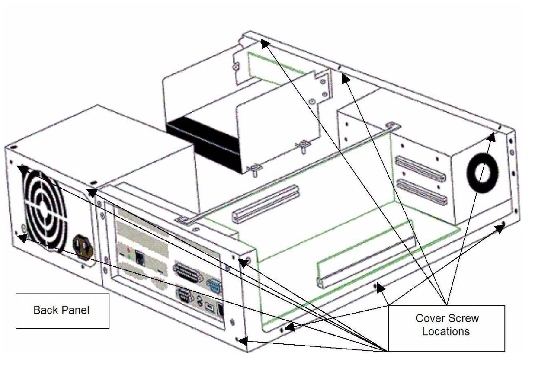

Remove the 5 cover screws holding the cover of the FaxPress Premier to the back panel, the 3 screws holding the bottom of the cover to each side of the chassis, and the 2 screws holding the front edge of the cover under the lip at the top of the front panel. The screw directly above the thumbscrew for the fan unit cover does not need to be removed, but you may need to loosen it slightly, as shown below. |
Remove only the FaxPress Premier cover screws. Do not remove any other chassis screws.
6.
Remove the cover by sliding it toward the rear of the FaxPress Premier, then lifting it upwards when it is free of the front panel lip. |

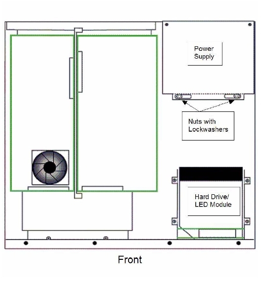

Locate the power supply module in the FaxPress Premier chassis as shown below. |
8.
Remove the 2 nuts with lock washers that hold the power supply to the base of the FaxPress Premier chassis. You may need to use needlenose pliers for this task. |
9.

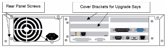

Remove the 2 rear panel screws that hold the bottom portion of the power supply to the rear panel of the FaxPress Premier.![](4_1.jpg) |
10.
Move the power supply to the side of the chassis, as far as the cables will allow. |

Locate the cover brackets covering the bays above the factory-installed T1/ISDN PRI board(s), as shown above. |
12.
Remove the Phillips screw anchoring the cover bracket and remove the cover bracket from the lower bay, if this bay is not occupied by a board. If the lower bay is occupied by a board, remove the Phillips screw that is anchoring the cover bracket for the upper bay, and remove that cover bracket. |

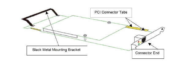

Remove the upgrade board from its packing material. Discharge static electricity from yourself by touching a grounded surface, attach a grounded static-dissipative wrist strap, and make sure the working sur-face is static-dissipative and grounded. Take care not to touch the connector tabs; hold the circuit board by the black metal mounting bracket, the metal faceplate with the analog line connectors, or the edges of the board. |
14.

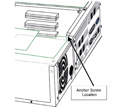

Align the board so the black metal end-bracket angles UP from the board. This will mean that the piggyback board is on the top of the main board, as shown below.![](4_12.jpg) |
15.
Engage one end of the black metal mounting bracket (the end the arrow above is pointing to) in the card guide, then lower the connector end of the board and slide the board into place, aligning the PCI connector tabs so they plug into the PCI slot on the chassis smoothly and firmly. |
Replace the anchor screw, to hold the upgrade board firmly in place. If only one T1/ISDN PRI board was factory-installed in the chassis, install the ribbon bus cable supplied with your upgrade kit on that existing T1/ISDN PRI board, and then connect it to the upgrade board you have added, attaching it to the connectors shown in the figure below.![](4_3.jpg)

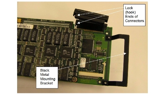

16.

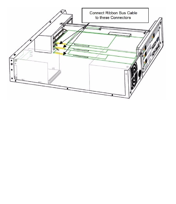

Make sure you install the ribbon bus cable with the lock (hook) ends of the connectors toward the BACK PANEL of the FaxPress Premier chassis, as shown in the figure below. This orientation will mean that the hooks are on the ends of the connectors that are AWAY from the Black Metal Mounting bracket, as shown. |
17.
To add two upgrade boards, connect the ribbon bus cable to both of the new fax boards. |
18.
If two boards were factory-installed prior to this upgrade, the ribbon bus cable will be in place; simply push the appropriate cable connector onto the board connector of the new board. Press the connectors firmly into place, to make sure there is a solid connection. |

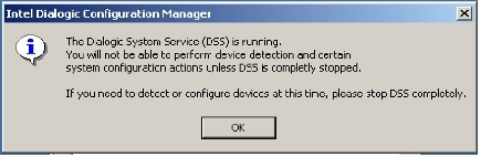

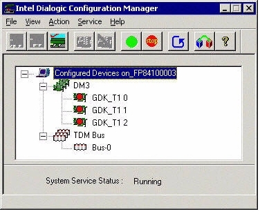

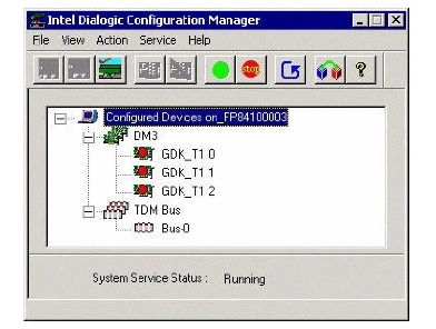

In the Intel Dialogic Configuration Manager window, click the [Stop] red button to stop the DCM Service, then right-click onand select to make the system rescan the boards. ![](4_6.jpg) |
16.
Click in the dialog box shown below. |
17.

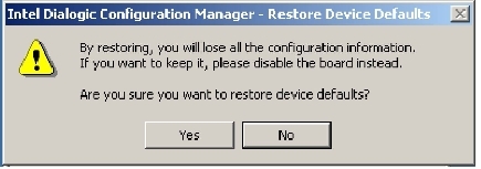

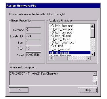

During the detection process, the Assign Firmware File window opens, and displays a list of .pcd files, as shown below.![](4_8.jpg) |
18.
For configuring a T1 board, find the gdk_t1_em.pcd file in the list, select it, and click OK. The software scan of the boards continues until complete. Then the Intel DCM window reappears, with all of the boards listed, and a red light displayed in each device icon, as shown on the next page. |
All boards should use the same .pcd file.
19.
Repeat step 13 for each additional fax board installed in the FaxPress Premier. |
20.
Select the first board (for example, GDK_T1 0 in the Figure above), and then click the green Start Service button in the menu bar. A progress bar appears on top of the background screen indicates the progress of the service startup. When all boards are started (all of the lights in the device icons are green), click and set it from to , then select the File>Exit command. |

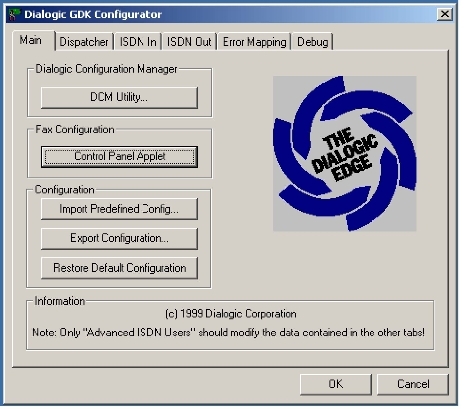

Click the Start Menu and select: |
Programs>Intel Dialogic System Software>Configure GDK
to open the Dialogic GDK Configurator window, as shown on the next page.
22.

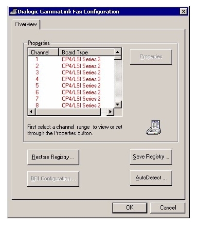

In the Fax Configuration section, click the button. The Dialogic GammaLink Fax Configuration window appears. See the figure above. |
23.
Click the button. A warning message appears. |
24.
Click . When the auto-detection process is complete, a message box appears, indicating that all boards have been detected. |
25.
Clickin the message box. The Dialogic GammaLink Fax Configuration window now displays the new number of supported fax channels, as shown below. |
26.
Verify that this number is correct. Then click to exit the Dialogic GammaLink Fax Configuration box. |

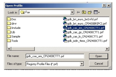

Click the button in the Configuration section of the Dialogic GDK Configurator window. The Open Profile dialog box appears, with the Registry Profile Files (.prf files) as shown below.![](4_17.jpg) |
28.
Select the .prf that matches the T1 line you have connected to the new T1 board (for example, gdk_cas_em_CPi2400CTT1.prf for a T1 board), then click . |
If you select the wrong profile file, the fax board’s behavior will be unpredictable. To correct this mistake, complete Step 21, and when the Dialogic GDK Configurator window opens, click the Import Predefined Configuration button again, and repeat Steps 19 and 20, selecting the correct profile file.

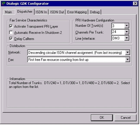

A dialog box asks how many trunks. Use the pull-down menu to select the total number of trunk lines that are now supported by the FaxPress Premier (each board supports one trunk line; if you now have 3 T1/ISDN PRI boards installed in your FaxPress Premier, it supports 3 trunk lines), and then click OK. The Dialogic GDK Configurator window appears. |
30.
Click the Dispatcher tab in the Dialogic GDK Configurator window, and look in the section of the tab, at the now supported, as shown below. |
31.
Verify that the in the section is correct. In the example above, 3 trunks are supported, which means 3 T1/ISDN PRI boards are now installed and configured. Click OK to close the window. This completes the T1/ISDN PRI board configuration. Next, go on to the final section, |
