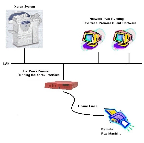

The FaxPress Premier Xerox Interface functions on a Windows NT or Novell network as shown below.
Make sure the FaxPress Premier server is configured in compliance with the requirements of your local telephone service provider.

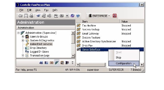

The FaxPress Premier’s Xerox Interface is one of the FaxPress Premier’s Embedded Services. To start or stop the FaxPress Premier Xerox Interface Configuration Wizard, follow these steps:
1. Log into FaxPress Plus as Administrator or as a Administrator-privileged user.
2. Select the Administration folder. (This folder is only available if you’re logged in with Administrator privileges.)
3. Select the Embedded Services folder.
4. Right-click on the Xerox Interface and select Start or Stop.
