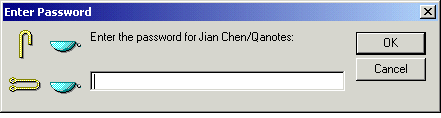

| 1. | Select Programs>Lotus Applications>Lotus Domino Administrator. |
| 2. | The Domino Server password dialog box appears. |
| 3. | Enter the password for the Administrator of the Domino server and click OK. |

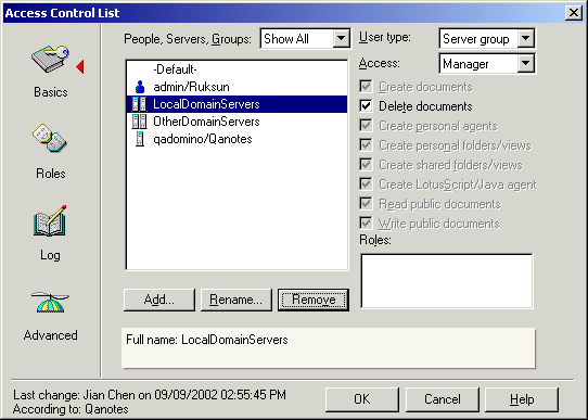

| 5. | Select Mail (R5.0), expand the Database button, then select Manage ACL. |

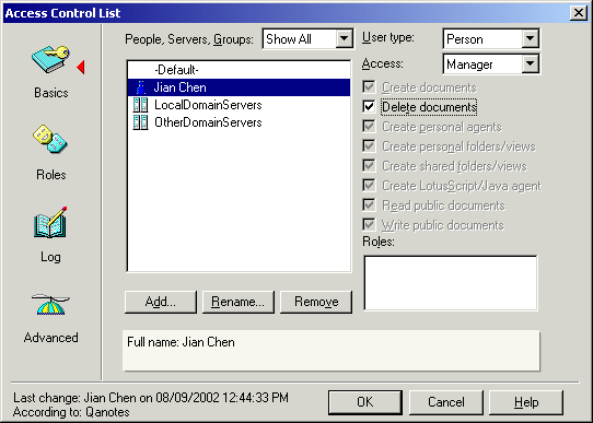

| 6. | In the Access Control List, click Add... |
| 7. | Enter the name of the Domino Server Administrator, then click OK. |
| 8. | Once the Lotus Notes Gateway’s user name has been added to the Access Control List, make sure full access is granted. That is, make sure all of the items in the Access list are selected, including Delete documents. Then click OK. |

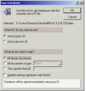

| 9. | Select Mail (R5.0), then Sign. |
| 10. | In the Sign Database window, make sure the Active User’s ID and All design documents radio buttons are selected, then click OK. |

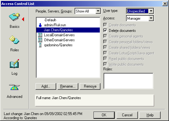

| 13. | With FaxPress Lotus Notes Integration/faxpress.nsf selected, click Manage ACL. |
| 14. | In the Access Control List window, click the Add button. |
| 15. | Enter the name of the Domino Server Administrator, then click OK. |
| 16. | Confirm the new Domino Server Administrator user appears in the People, Servers, Groups list, and has full access rights. That is, make sure all of the items in the Access list are selected, including Delete documents. Click OK. |
| 17. | With the FaxPress Lotus Notes Integration/faxpress.nsf selected, click Sign. |
| 18. | In the Sign Database window, make sure the Active User’s ID and All design documents radio buttons are selected, then click OK. |

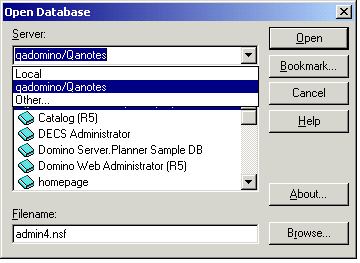

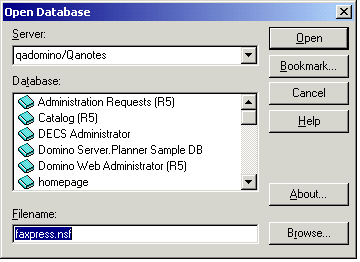

| 20. | In the Domino Administrator window, select File>Database>Open to bring up the Open Database window. In the Open Database window, select the Domino server. |
| 21. | In the Filename field, enter faxpress.nsf, then click Open. |

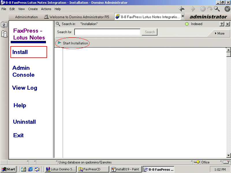

| 22. | In the FaxPress-Lotus Notes Integration Setup, select Admin Console in the left panel, and click Setup. |

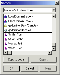

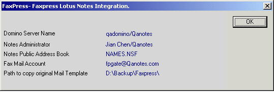

| 23. | In theFaxPress-Lotus Notes Integration window, use the pull-down menu tabs to enter the setup information required by the FaxPress script. Specify the Domino server name, the Administrator account name, and the Notes Gateway account. Note that the The Notes Public Address Book field is not modifiable. |
| 24. | Use the Domino Server Name pull-down tab to open the Names window. Select the Domino server to use with the FaxPress, then click OK. |
| 25. | Confirm the FaxPress-Lotus Notes Setup Information is correct, then select Save and Exit. |
Domino Server Name - name of the Domino server used with the FaxPress

| 26. | Select Install, and click Start Installation. |
| 27. | Click the Start Installation button. |
| 28. | Confirm the setup information is accurate, then click OK. |

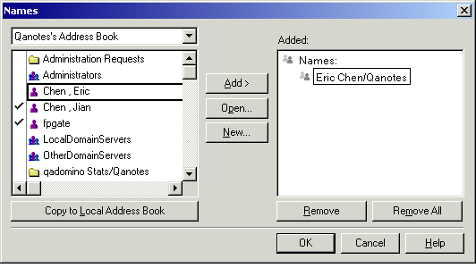

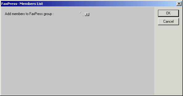

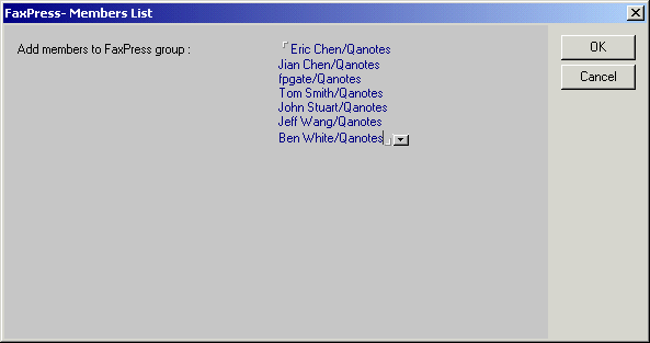

| 29. | Use the pull-down tab to add your Lotus Notes users to the FaxPress Members list. |
| 30. | Check the users to select them from the Address Book list and click Add to add then to the FaxPress list. Click OK. |
| 31. | Confirm the members list is complete, then click OK. |

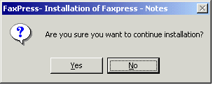

| 32. | Clicking OK in the previous step will bring up the following confirmation dialog box. |
| 33. | Click Yes. Clicking No will also terminate the installation and generate the message above. Setup will now begin copying files. |

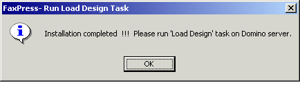

| 34. | When the Installation completed dialog box appears, click OK. |

Running the Load Design script adds the FaxPress forms to the Lotus Notes inbox, providing fax/email integration for users. To run the Load Design script, follow these steps:
| 1. | From a Domino Server Console command prompt, type > load design, then enter. |
