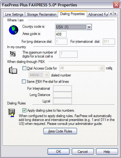

| 3. | Select the Dialing Properties tab. The information here is required for PBX outbound integration, but is not specifically required for automatic inbound routing. |
If your PBX system requires passwords for access to an outside line, check Dial Access Code in the When dialing through PBX. From the pull down menu on the right select whether to insert the password Before or After the number is dialed.

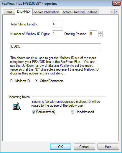

| 4. | Select the DID/PBX tab. |
Use the Total String Length field to enter the number of digits the PBX passes in the complete string, including the mailbox ID.
Use the Number of Mailbox ID Digits field to enter the number of digits used in the mailbox ID. The FaxPress Premier supports up to 7 digits for the Mailbox ID, although Mailbox IDs are more commonly 3 or 4 digits.
Use the Starting Position field to enter the mailbox ID’s starting position in the string, i.e. whether it’s positioned at the beginning, in the middle, or at the end of the string.
Use the Mask Value field to enter the entire digit string passed by your PBX system or DID trunk line. Use DDDD to represent the digits the Premier will use for the Mailbox ID, and X to represent the unnecessary digits the Premier will strip. The FaxPress Premier supports up to 7 digits for the Mailbox ID, although Mailbox IDs are more commonly 3 or 4 digits.

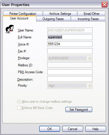

In the User Properties screen, with the User Account tab selected, enter an identifier number in the Mailbox ID field. The identifier number may contain up to 7 DTMF or DNIS digits, although more commonly the Mailbox ID will be 3 or 4 digits. If necessary, enter a PBX access code in the PBX Access Code field.

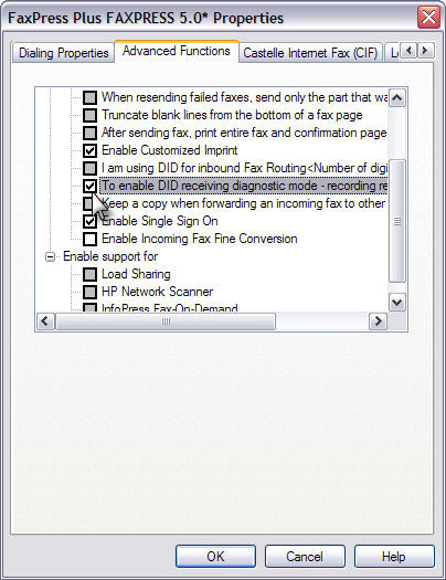

To enable the DID receiving diagnostic mode, follow these steps:
| 1. | Select the Advanced Functions tab. |
| 2. | Check To enable DID receiving diagnostic mode. |
| 3. | Click OK. |

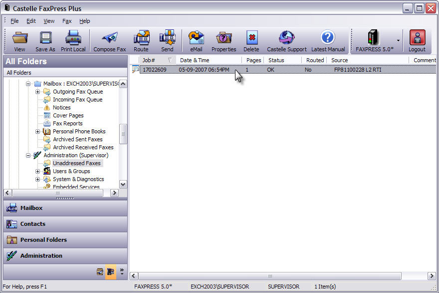

| 5. | Open the Unaddressed mailbox to confirm the test fax has been received. (All incoming faxes will automatically sent to the Unaddressed mailbox until Premier users’ mailboxes are configured for automatic inbound routing, with Mailbox IDs mapped to fax numbers, etc.) |

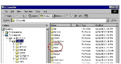

| 6. | Next, use Windows Explorer to browse to the Premier’s C:\Castelle\Data directory. Use either Remote Desktop or a local mouse, keyboard, and monitor attached to the Premier to log in. (See Required Setup Proceduresfor information on using Remote Desktop.) |
| 7. | Open the dtmf.log file to see the complete string of digits the Premier is receiving. Use this information to determine the digits required for your users’ Mailbox IDs. (See Configuring the User Properties: Mailbox IDs.) |
